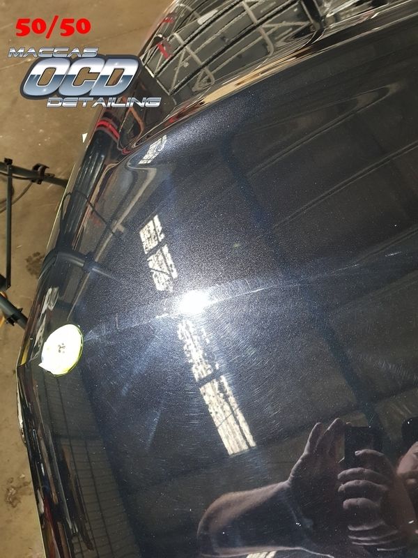

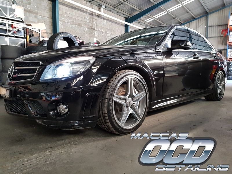

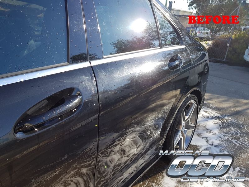

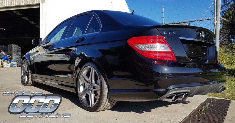

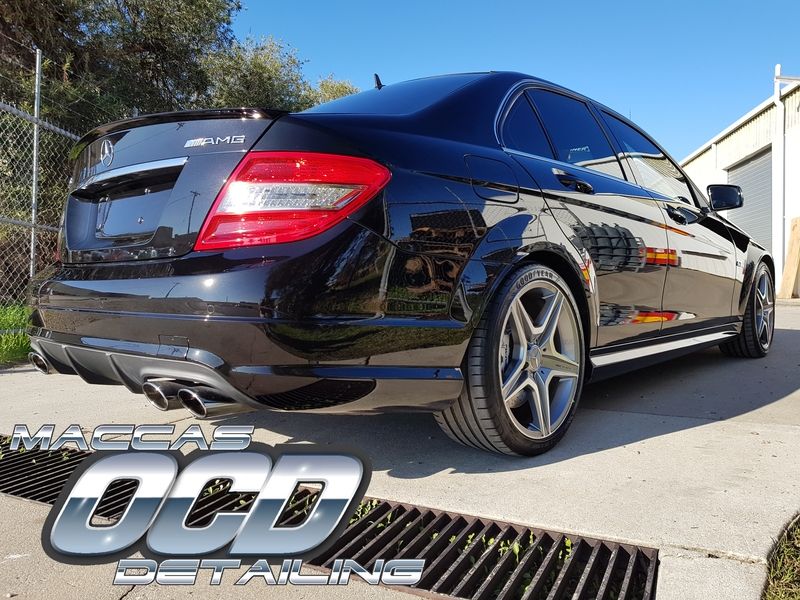

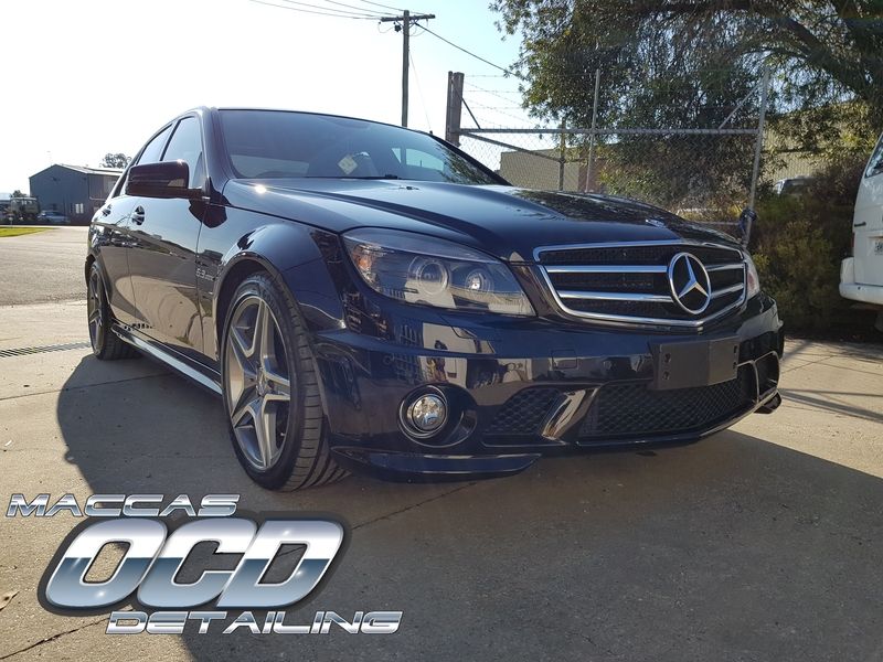

    Well over the past 2 days I have been working on a black AMG C63 and the poor thing had seen better days, neglect in its care and someone that didn't know how to use a buff properly causing burn marks. So the owner came to me to rectify and bring it back to its former glory.
    Process:
    - Full decontamination wash
    - Mask up and paint assessment (worse than originally thought)
    - Using DK 1.1 and Americana MF Cut pads started to attack getting good results, but had to cut the whole car twice due to the amount of damage
    - 2nd stage took to it with a Rupes Yellow Foam and Rupes Yellow/Fine Compound with great clarity coming through
    - Wipes down with Carpro Eraser
    - Sealed with Cquartz UK
    -Tyres dress with Ammo Mud
    Heres some pics hope you enjoy
