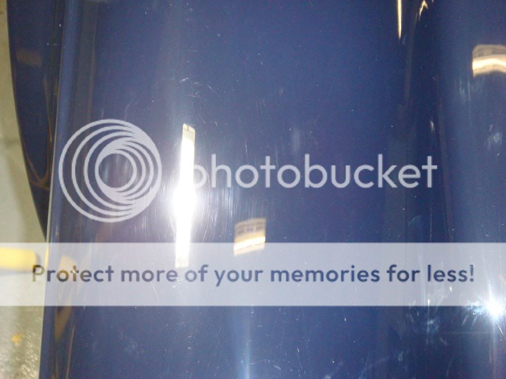

    Some shots of the paint defects under Metal Halide lamps
    Bonnet
    It got a Stage 2 machine polish which involved Menzerna P091L with Orange LC pad for the 1st stage and Menzerna 106ff and White LC pad for 2nd stage.
